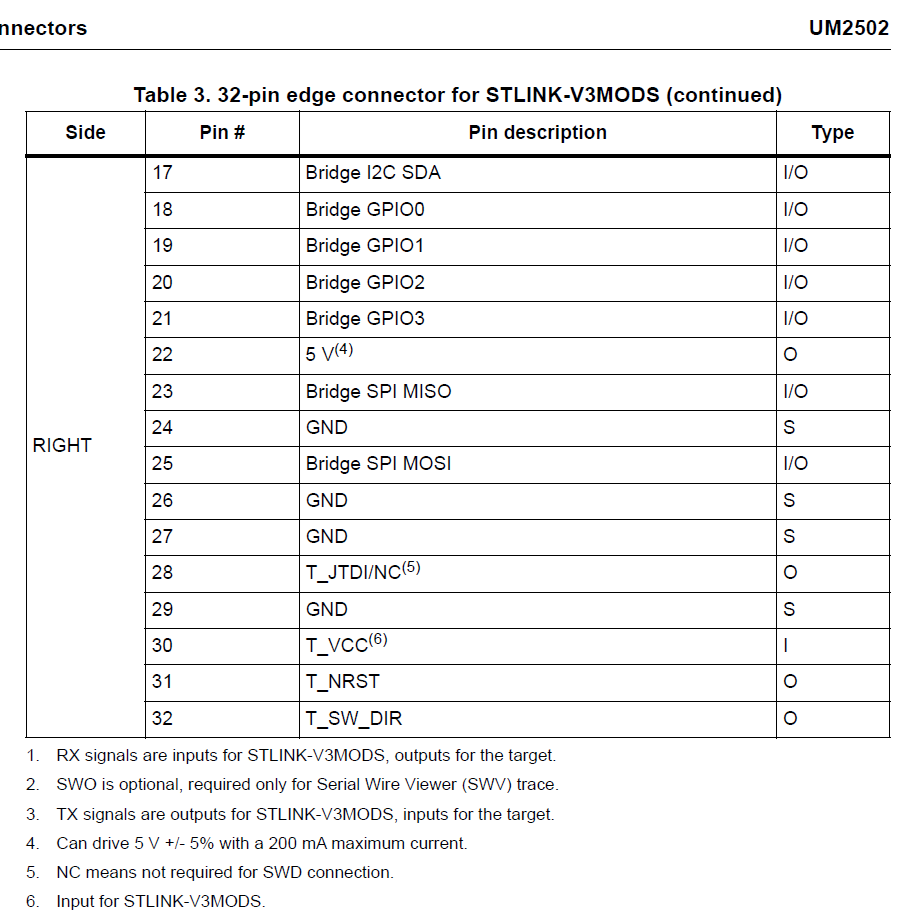

This question pertains to the (relatively) new STLINK-V3MODS programming/debugging device.
The UM2502 Users Manual for this product goes into great detail about using Pin #22 of the castellated edge connector aka +5V for ancillary purposes:
"Pin 22 of the right edge pin connector can drive a 5 V target with a maximum output current
of 200 mA. The 5 V pin is guaranteed to be in the +/- 5% range if the driven current does not
exceed 200 mA."
I attached an ohmmeter between pin #22 and the board's +VBUS pin on its USB connector. Because +5V power from pin #22 would be derived from +VBUS pin I expected to see near zero ohms between these nodes. However, I did not and I'm curious why not.
Is there a microcontroller-enabled pass transistor between +VBUS and pin #22? When is this transistor enabled?
Yes, there is a power switch between the 5V coming from the USB port and the pin #22.
I don't have the exact details, but the ST-Link V3 firmware decides when to enable it.
Most of the time, it should be ON.
The LD3 green LED will be OFF if the power switch is not enabled.
