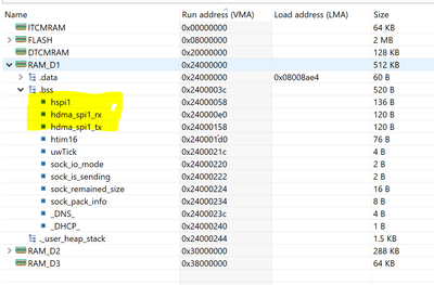

In RAM_D1 Region

What do you mean by RAM_D1 Region? DTCM RAM or AXI-SRAM?
2024-06-11 6:27 AM
