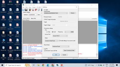

what is the process to"connect under reset"?
Try connecting the BOOT pin to VDD.
how it is to be done, is there any jumper setting?

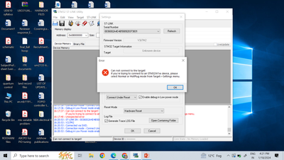

i've tried the suggestion  "connect under reset" as follows
but it is not working following msg is generated

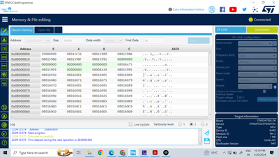

sir,
as suggested i've used STM32cube programmer.
Now the board is connecting to STM32cube programmer. it is reading memeory and other stuff from the board.
i've not erased the memory or programmed it from STM32cube programmer.
But still when i try to program it from IAR workbench, it is unable to program the board.
