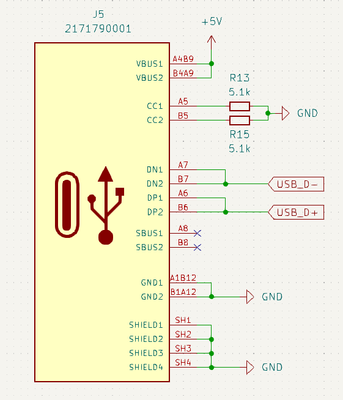

Screenshot of the USB connector:

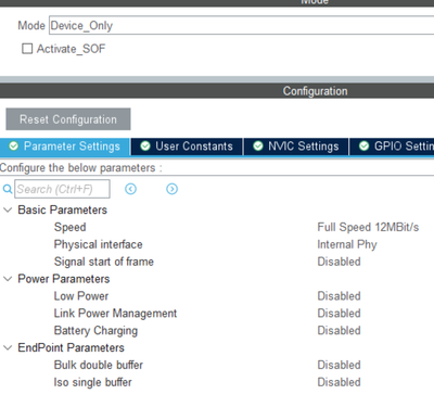

And here are screenshots from CubeMX configuration:

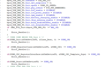

And the intialization of the USB from the code perspective:

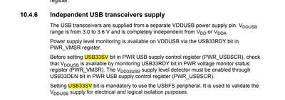

For every newcomer to the STM32H573 micro this is a key chapter regarding the usb:
This code does the job done:
HAL_PWREx_EnableUSBVoltageDetector();
while(!LL_PWR_IsActiveFlag_VDDUSB()){}
HAL_PWREx_EnableVddUSB();Aadditionaly remember to enable the Flash!:
Thanks @waclawek.jan for the reminder that the reference manual is always our best friend in such situations.

I don't know the 'H5, but generally:
- read out given register content and check if given bit is indeed set
- make sure all clocks necessary are up and running (in some STM32 there are several separate clocks for USB core and USB PHY)
- in some STM32 USB PHY is in a separate power domain (separate VDDIO/VDDUSB or similarly named pin) so make sure all VDD pins are powered properly
You've read thoroughly the initial chapters (including PWR, RCC, SYSCFG) and the USB chapter in RM, haven't you.
