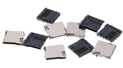

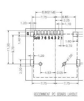

Here the card holder usually has a switch to case/gnd, so its easy to detect a card-is-in , ie with a pin+pullup connected to this switch. Other way is just send command -- and wait for response, or not.
Cd is this card-detect pin:
