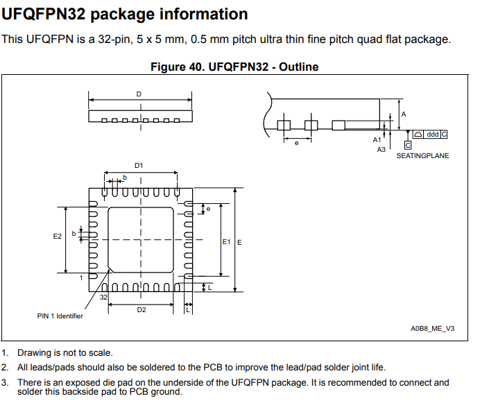

Hello @MFatt.1 and welcome to ST Community,
As mentioned in the datasheet :
>> There is an exposed die pad on the underside of the UFQFPN package. It is recommended to connect and solder this back-side pad to PCB ground.
Hope that helps!
