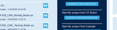

You can use STM32CubeMx and select Access to the board:
And type "STM32G0":

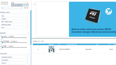

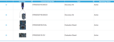

These are the available boards for G0 product:
So No EVAL board available for this exact part number but only Nucleo board:
STM32G0B1CE is a 48pin package while the Nucleo board is a 64 pin package. You can use it and adapt it later to your application. Both part numbers yours and on the on eon the Nucleo board have 512kB of flash.
