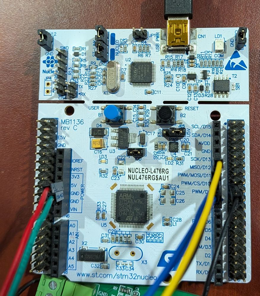

I've been struggling with this issue for a couple days, I have a Nucleo-L476RG board that I am trying to run and debug in VS Code.
I'm using the STM32CubeMX + STM32 VS Code Extension tool chain to create cmake files, build, and then debug, but I cannot run and debug code due to an error:
Error in initializing ST-LINK device.
Reason: ST-LINK firmware upgrade required. Please upgrade the ST-LINK firmware using the upgrade tool.

I'm using a Nucleo board with the integrated ST Link instead of a dedicated ST Link device. Not sure if there are Nucleo board clones but this one seems genuine?
