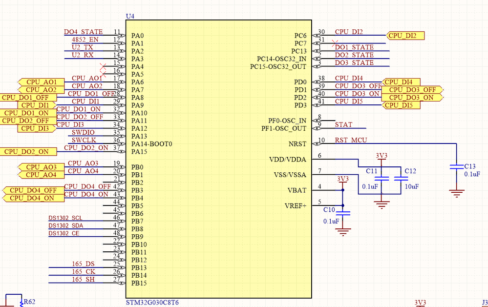

HI,I use the G0 serials firstly. I have welded 8 model machines,but I found some similar problems.
For example
When I heat the MCU,Those two questions maybe get better large probability�?(but I am sure the electrical connection is OK,not short or break )。
Tks�?
2022-03-15 8:43 PM
If only 2/8 boards are acting poorly, and not in the same way, surely the reason is that the hardware is different/faulty. If not a bad solder joint, then a bad board.
PF1 is next to NRST
PD0 is next to PD1
I know you said you checked it, but it sure looks like a solder bridge issue to me.
2022-03-15 10:55 PM
Thanks for your reply very much�?
I fact the 8 boards all have the problem! The 8 board were producted and welded in 3 batches。
The First time I found the problem ,I headted the board and It got OK.So I think it is a problem of solder joint .Even though I can't see the joint .
The Second time I met the same problem.and I solved ti by heating too.
The Third time the same. So I think it is not a simple weld issue and start the investigation.
We use the STM32F103R8 all the time.and never met the problem.so I wonder if it has something to do with the chip.
2022-03-16 7:07 AM
I'm not sure. It seems like a hardware issue to me.
