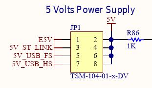

try:
set PD5 lo. (is this small test program or part of something big? )
or can try:
solder close sb18. and JP1 5-6 set on.
