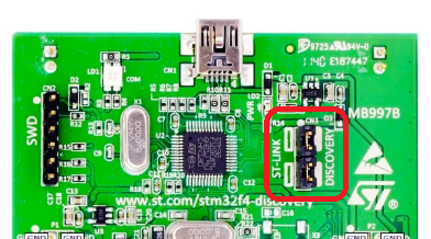

3- What about the following jumpers? are they fitted?

3-Yes, the jumpers are present and correctly fitted

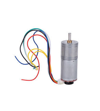

a motor encoder

Do you mean this motor?:
If yes how did you connect it?
How did you connect the motor itself (I'm not talking about the encoder) but about the motor itself? directly or over a power stage dedicated to interface a such kind of motors?
2026-04-24 7:40 AM
i've used a power stage (l298n motor driver )
