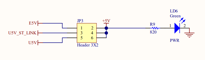

@pass3master wrote:Specifically, we want to program LD6(PWR) of STM32F412G-DISCO.
But that LED is not programmable: it is hard-wired to the 5V supply - there is no connection to the STM32:
https://www.st.com/resource/en/schematic_pack/mb1209-f412zgt6-d04_schematic.pdf#page=4

In the default design, LD6 is not programmable.
if you want to program LD6, the way is :
Step1: To remove R9.
Step2: To connect a GPIO(you can use resource from Arduino connector) to LD6 directly.
Step3: Program the GPIO you use.
Note that, brightness of LD depends on GPIO output capability.

@Sco wrote:Step2: To connect a GPIO (you can use resource from Arduino connector) to LD6 directly
Don't connect directly - connect via a suitable resistor!
eg 510 ohms is used for the other green LED:
