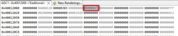

I think I have all three channels set the same sampling time setting. For example, for setting 1, this is the ADC1->SMPR2 (offset 0x10) register value before the DMA starts and the value is unaltered when it stop. See image:
ADC1 offset 0x10 set to 0x49 (i.e. all three channels are configured for '1')
2024-03-06 9:20 AM
> (ADC IN0, IN1 & IN4)
You have channel 4 sample rate (SMP4) unchanged. Setting up SMP2 affects channel 2 (IN2).
2024-03-06 10:01 AM
You were right, I just could not see the issue.
