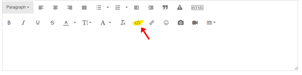

Edit your post and use Code Sample so it formats your code which makes it easier to read your code
