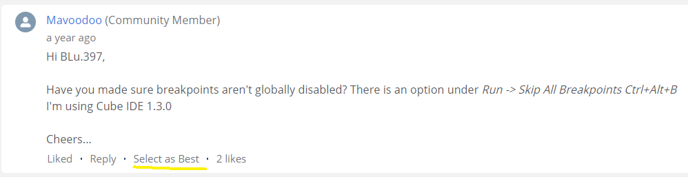

There is a "Select as Best" button at the bottom of the Mavoodoo's answer as you see in this screenshot :
Imen

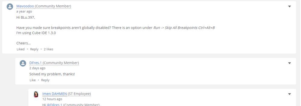

2021-03-18 12:45 AM
Here is actually the view from my side @Imen DAHMEN , no buttons there.
But thank you for the prompt answers anyway.
I appreciate it, have a pleasant day.
