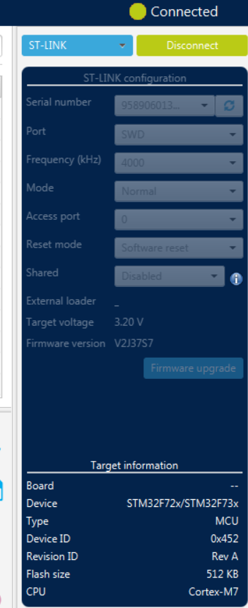

Right. Sorry for the lack of details, I wanted to be as specific as possible.
The board is STM32H750. CubeProgrammer is not recognizing it correctly and the device should not be F723.
I am using ST-LINK V2 connected to the SWD of the board and power it up via the VIN and Ground (5V) and selected the JP8 to E5V.

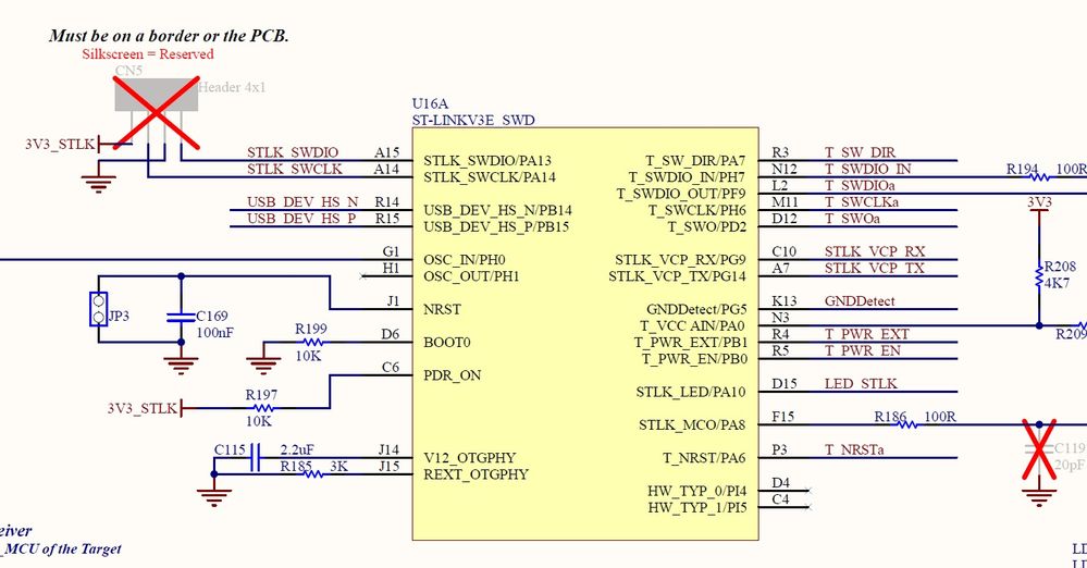

CN5 on the STM32H750B-DK goes to the ST-LINK/V3 chip

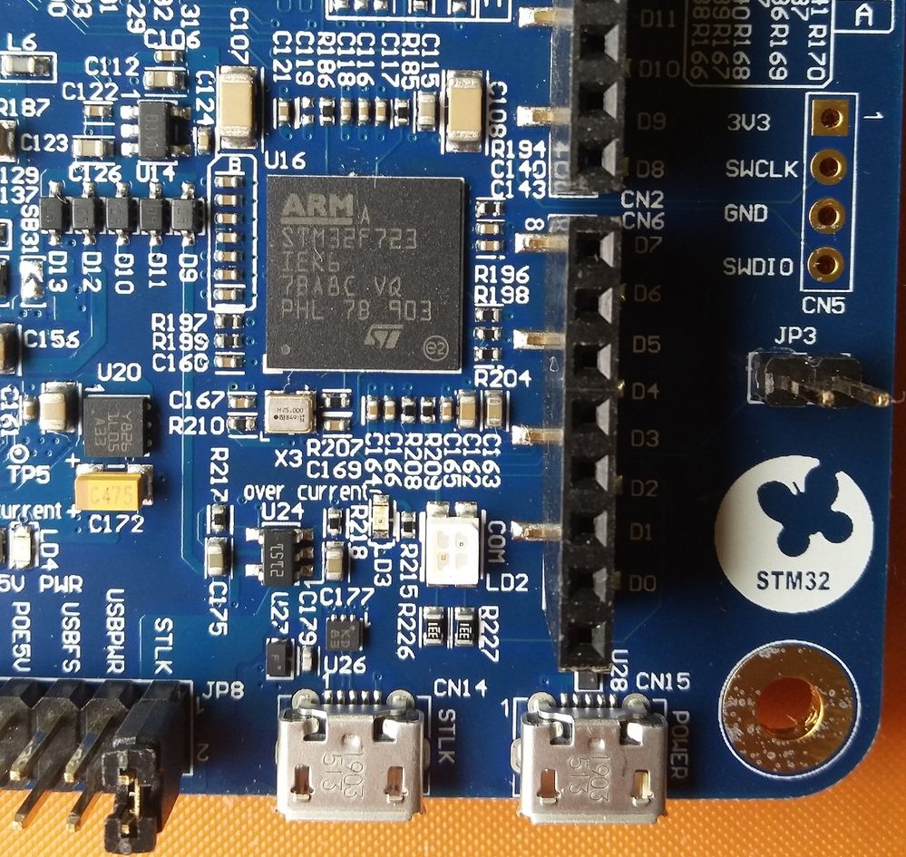

The board has an on-board ST-Link which you should use to program it on USB connector CN14. You don't need an external programmer. This is true for the vast majority of ST boards.

The only way I can power up the board is with E5V on JP8. But, the PC is not recognizing the board (according to the picture above).

FFS, this is an uphill ski, I've told you it implements the on-board ST-LINK/V3
Here's a picture to save me 1000 words..
