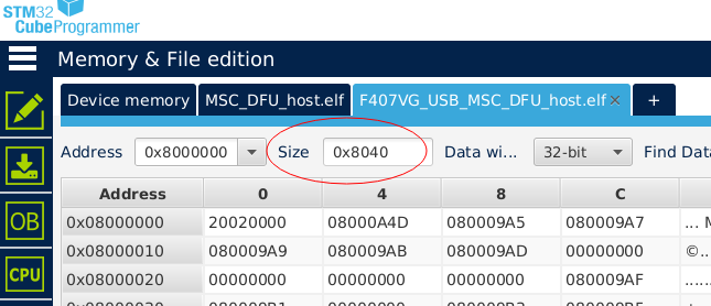

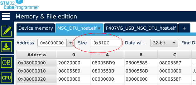

When looking at the original code, using the STM32CubeProgrammer, we see that this code has only 0x610C (ie it is below 0x8000).
The code generated in release mode in STM32CubeIDE 1.9.0 has the size: 0x8040.

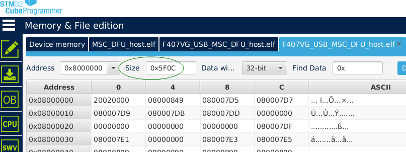

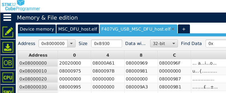

I tried to disable the USB debug and the serial port, but even then in debug mode the code is still this size: 0xB930. Only in release mode it has this usable size: 0x5F0C.
