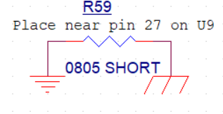

2025-03-18 9:36 AM
Separate grounds that are connected via this 0805 short:
2025-03-18 10:26 AM
>>What could be happening that causes the processor to fail?
You've created a conduction path through the MCU, and an excessive amount of current is flowing.
Like you have a board with significant power differentials, and the grounding between them is not working, or presents more resistance than the path it's found here.
Are these parts on the same board?
What voltages involved?
If you remove the STM32 from the circuit, what current flows between this pin, and ground or the supply?
Double check the netlists for the board, make sure you've not created multiple separate islands that should have been connected, and weren't or were miss-named.
