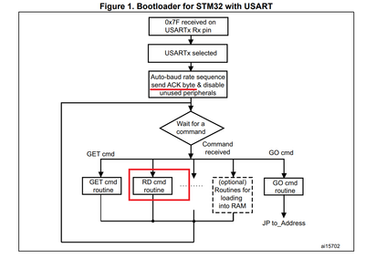

The system boot UART protocol is inherently bidirectional. See AN3155 Application note and
How to utilize STM32 system (ROM) bootloader comma... - STMicroelectronics Community.
You may however implement your own custom bootloader in flash. This could use any interface you like.
If you must opt for that single UART pin, consider a 1 pin half-duplex protocol or the optional RX/TX pin swapping capability of many STM32 UARTs.
