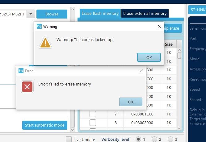

I am using STM32 CubeProgrammer to program a Nucleo F-103RB via the OBD. When I power up the board, I can connect to ST-LINK and program the board. However, if I try to program it a second time, I get some errors:
and it doesn't program. If I do nothing else but close those error messages and try to program again, it successfully completes. This is 100% repeatable.
Is there something I need to do before re-programming a board to avoid those errors?

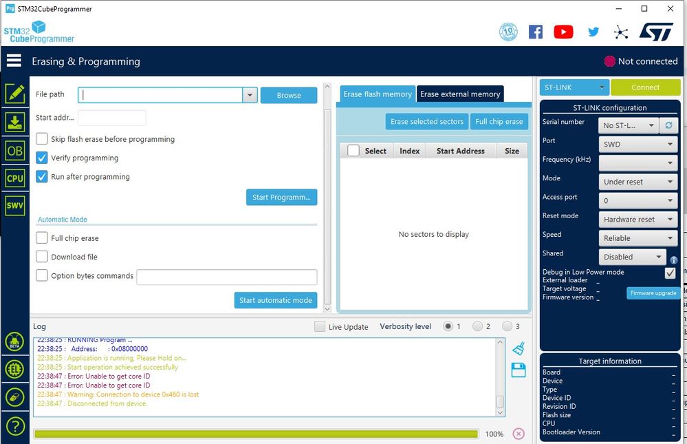

GPIO configuration for SWD/JTAG pins, low-power modes, watchdogs and option bytes definitely can have an impact on debugger.
Also set both of these for the debugger:

2022-06-07 7:40 PM
@Piranha: Thanks for the response. I already had reset mode to hardware. I changed Connection mode to "Under reset" -- but it did not have any impact.
