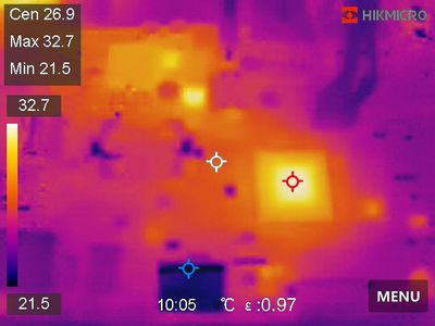

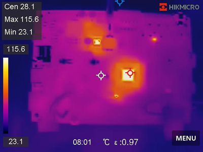

It turned out that something burned in the programmer. I havent found schematic for it :\ And MCU is broken, It is getting 100*C hot after several seconds - see thermo photos.
Here programmer:

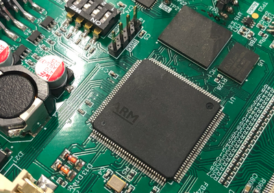

Here MCU, programmer connector marked as SWD. Coil on the left side is part of step down regulator - the regulator IC is visible in thermo fotos when broken MCU draws too much current.
Here 115*C on broken MCU - 12V, 5V and 3.3V power sources are fine.
