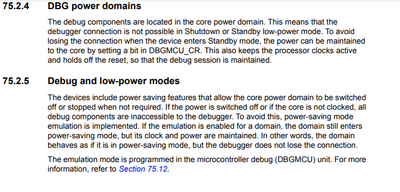

2023-09-05 5:09 AM
Hello Gautham19,
My first question is did you make sure that you still have your debug access available even in stop mode?
Because if you read the RM you will see that if not configured correctly you lose access to your debug in STOP mode.
Regards,
Stassen
2023-09-05 6:05 AM
Hi Stassen.C,
The DBGMCU->CR register is not set
Still I could able to Debug in stop 1 mode without any issue.
2023-09-07 2:38 AM
Hi Gautham,
Did you do the test with the DBGMCU->CR set ?
Stassen
