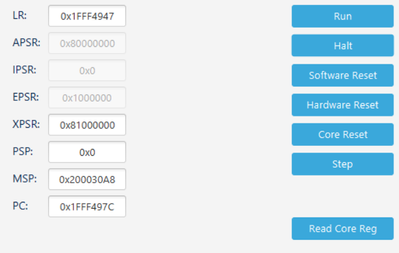

I activated bootloader and I did it correct, because in the CPU tab, when the core is Run and then Halted, the ProgramCounter is in the 0x1FFF XXXX range

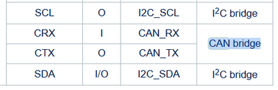

External STLINK-V3PWR CAN bus pins (CRX,CTX) I connected to external transceiver sn65hvd230. This transceiver have powersupply from nucleo too.
STLINK-V3 TVCC to 3.3v nucleo, STLINK-V3 GND to GND nucleo.
Second transceiver sn65hvd230 are connected to PB8, PB9. Power supply from nucleo

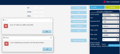

Unfortunately, there is no feedback from nucleo while trying to connect by external STLINK-V3, by CAN bus.
I checked on oscilloscope and signal from STLINK-V3 is going to nucleo correctly.

I did a test on bootloader, on the UART protocol too. Unfortunately, form external StLink-v3PWR it doesn't work (I connected GND, TX->RX, RX->TX. Power supply from nucleo USB. Didn't touch jumpers).
But if i tried with programmer from nucleo (built-in, not detached), it works.
I have any idea why it doesn't work on external programmer.
