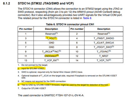

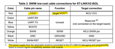

2024-03-13 3:56 PM
That's all I can find for this board.
There are probably older versions floating around Google. No official "old version" repo is available. I doubt the older versions have more information--usually manuals are expanded in new revisions, not redacted.
You can read about T_VCC on other ST-link user manuals. It serves the same function here.
Probably GND_Detect is on other programmers as well. Yes, here is both of them in a little more detail.
