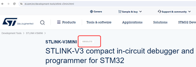

The STLINK-MINI is obsolete:
As mentioned by @Peter BENSCH , the STLINK-MINIE is the recommended replacement, but that doesn't have the castellated contacts for soldering onto a board - so wouldn't be any use anyhow.
So that leaves you the STLINK-V3MODS - which does meet your requirement.
