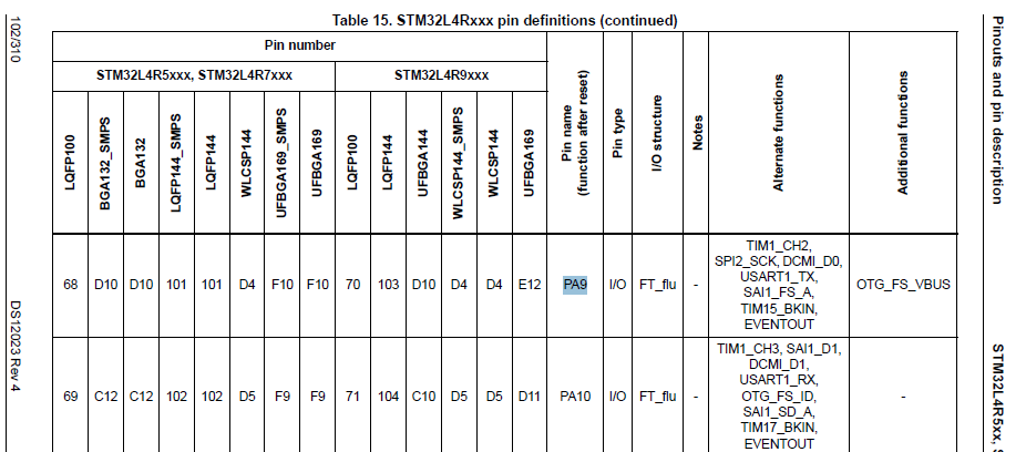

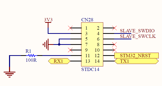

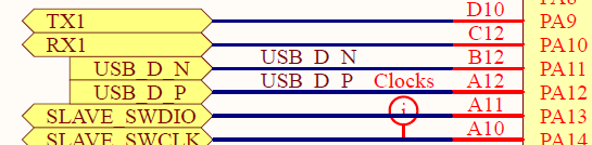

I'm using STM32L4R5 which USART can swap RX/RX. Unless (boot) is needed, it's less of a worry. SPI naming rule is much better (MISO/MOSI) to avoid confusion.
I have a board working, here is the extract info for reference:
Which TX1/RX1 are :
Which correspond to :
I guess with these info, the question is answered :grinning_face_with_sweat:
