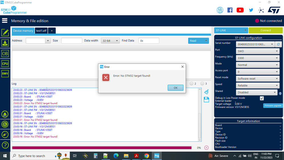

We are providing power to our Customised Microcontroller (STM#@ C series) board from my power supply@3.3v. we are using STLINK-V3SET with MB1440 adapter, it is an extension board provided by ST.
We have connected 3 PINS GND, SWDIO(PA13), SWDCLK(PA14) from CN6(connector 6) of extension MB1440 board. to our microcontroller board.
Getting above error.

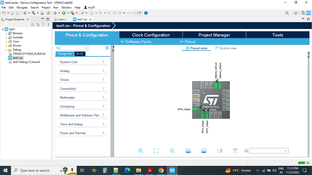

NOTE: Clock used is internal & pinout as follows:

2023-11-22 10:53 AM
with stlink-V3 you have to connect VDD 3v3 from target to stlink. See : it shows 0,0V at target, refuses to work.
so connect the 3v3 ! (reset is not needed, if you use software reset, as you do. )

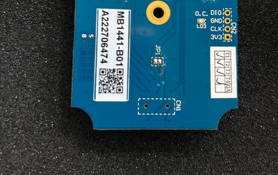

Any idea if i can use RFU connector CN2 from STLINKV3-MB1441 board to power up my microcontroller. 3.3v is available on this connector.
Thanks in Advance.

Or is there anyway to power target microcontroller from stlinkv3 debugger?
2023-11-22 11:22 PM
no.

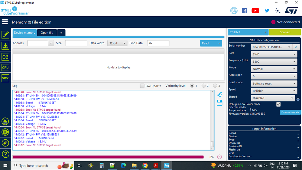

2023-11-23 12:46 AM
Still getting target not found. Any way to check my microcontroller is working fine.
On reset pin getting 3.14v.
Few GPIO's showing 0.2v
Few GPIO's showing 3.14v.
