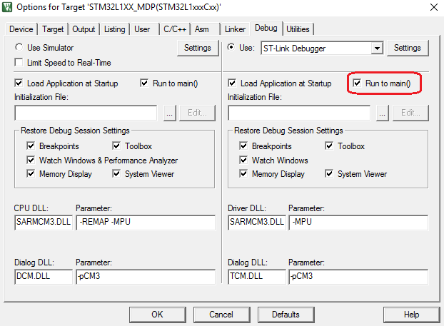

Do you have 'run to main()' unchecked?
Normally Keil brings up the debugger, and then attempts to get you to the first line in main() using a break-point. If code between the ResetHandler and there fails or loops, it will never get there.

Hello
If you want to go directly to the main function after starting the debug session, check the option
''Run to main()''
in ''Options for Target'' (ALT +F7) -> Debug. Note that there is the ''SystemInit()'' function called before main (as you can see from the startup). You should be able to enter the function from startup by using Step key (F11).2016-12-09 1:22 PM

The Run to main() was checked

The question seems to indicate the OP wants it to get to main(), but it is not, it is stuck somewhere between and never gets there. With 'run to main()' checked, as it is by default, you'd have to press the stop button to regain control and see where it is actually stuck.
2016-12-09 2:27 PM
Make sure the 'Update Target before Debugging' is checked in the Options/Utilities pane. And 'Load Application at Startup' is also checked in Options/Debug pane
