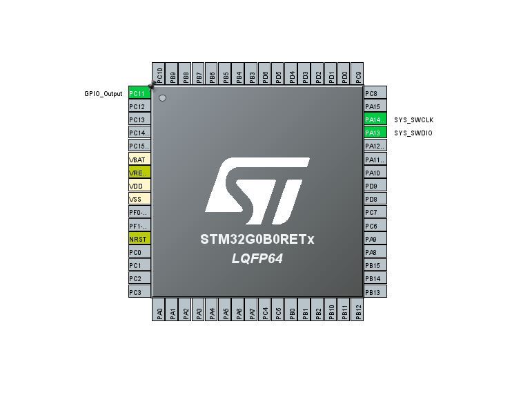

i have this connection to stlink v2 clone and i am using stm32cube ide
pins connection to st link v2 are
VCC - 19 of stlink v2
VSS/GND - 20
swdio- 7
swclk - 9

Hi, found the solution.. reset circuit must be connected and program is done using STM CUBE IDE.
we can program G series with st link v2 .
