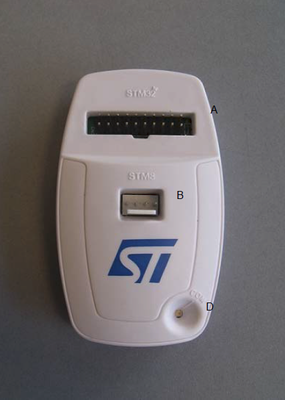

I am experiencing an issue with my ST-Link V2 debugger. When I connect it to my PC, I often receive the error: "USB device not recognized: Unknown USB device (Device Descriptor Request Failed)" and ST-LINK orange LED turns on. However, after several re-connection attempts, it works with full functionality .
Troubleshooting Attempts So Far:
Reinstalled ST-Link drivers
Updated ST-Link firmware
Any advice or suggestions would be greatly appreciated!
Thank you in advance for your support!

Is it a genuine ST-Link?
Standalone, or part of a dev board?
A Windows PC?
If it's intermittent, it could be a faulty/broken connector ...

It's Standalone ST-LINK/V2 from ST , Windows PC , Tried different USB cables, ports, and PCs
https://www.st.com/en/development-tools/st-link-v2.html
