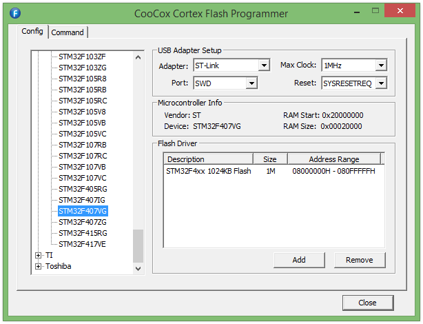

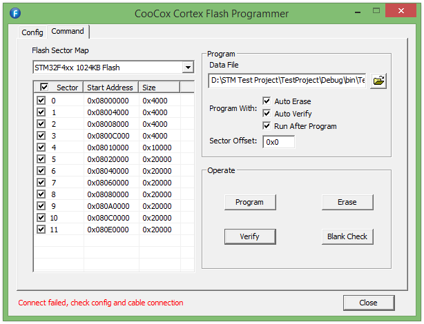

You're perhaps going to want to try the BOOT0 HIGH trick. Or HWRESET option
/public/STe2ecommunities/mcu/Lists/STM32Java/Attachments/1453/cooflash_stm32f4disco.gif
________________ Attachments : cooflash_stm32f4disco.gif : https://st--c.eu10.content.force.com/sfc/dist/version/download/?oid=00Db0000000YtG6&ids=0680X000006Hz9Z&d=%2Fa%2F0X0000000bMU%2FEtuwTNSB46N98TNf7vpL.z8s4s3CbijLgEl8pqmMaEM&asPdf=false2014-09-08 11:54 PM
