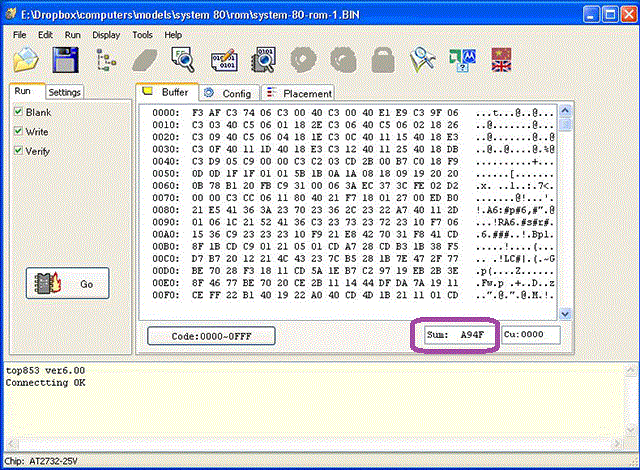

As posed the question suggests it's the 16-bit or 32-bit sum
03/25/2011 11:48 AM 131,072 hi8_U20_8bin
03/25/2011 11:48 AM 131,072 lo8_U18_AB7F.bin
2 File(s) 262,144 bytes
0 Dir(s) 402,133,188,608 bytes free
Most of these would be a sum of bytes truncated to 16-bits. Personally I prefer CRC's as the byte ordering would impact them.
