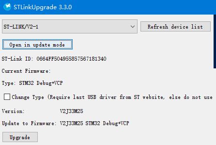

My board is NUCLEO-H743ZI. I change the ST-LINK type from STM32 Debug+Mass storage+VCP to STM32 Debug+VCP.

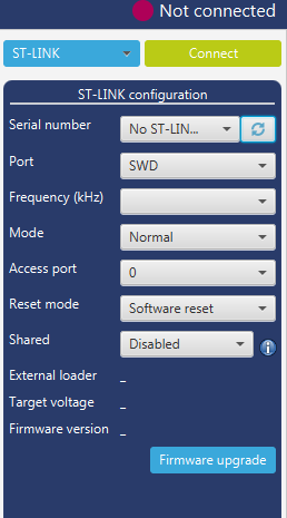

But after the change STM32CubeProgrammer can not detect the ST-LINK.
It might be a hardware ID issue?
The usb pid of STM32 Debug+Mass storage+VCP is 374B.
STM32 Debug+VCP is 3752.

It seems STM32_Programmer_CLI v2.0.0 works fine.

I observed the same issue.

Why do you want to change type? Debug and VCP is for old Stlink V2, V2/1 is Debug + MSD + VCD. But the message box seems strange.
2019-04-23 11:51 PM
I never use mass storage mode.
