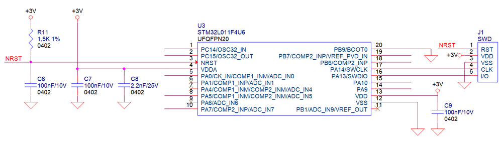

And here is the schematic.
The 3V power supply is stable.
