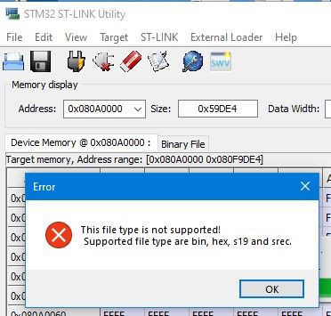

I'm trying to program a 32-bit STM32 Cortex-m4 MCU (specifically STM32L4P5ZGT6P).
I'm using v 4.6.0 of ST-Link Utility, and I've tried both an ST-Link V2, and an ST-link V3, both with latest firmware.
Both succeed at connecting (reading) the MCU, but I can neither wrote firmware, or delete the chip. Both give me the error. "The elf loader file is not accessible".

10:43:48 : The elf loader file is not accessible.
10:44:00 : Error occured during flash mass erase!
Now here's the strange thing: It works fine when I use STM32CubeProgrammer. So my question is: Why does ST-link Utility 4.6.0 not work? Is this program obsolete?
Edit: I forgot to mention, I am not even using an elf file. I am using a hex file.

ST-LINK utility does not seem to support writing elf files.
2020-12-09 12:03 AM
Oh, I failed to mention this important fact in my post: I wasn't even using an elf file. I was using a .hex file. And furthermore: even if I ONLY try to erase all on the chip, I get an error message about elf files, for some reason.
