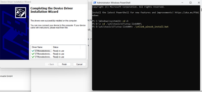

I have been trying various methods of installing the ST-Link USB drivers on my Windows 11 Laptop, with absolutely no success. Here is the output I see when I try to run the installation batch file from the stsw-link009 download:

When I open the properties on the ST-Link device, it (obviously) says that the drivers are not installed. Needless to say, if I try to run a program form the Cube IDE, I get a "No-ST-Link Detected" message. Also, if I open a project on the mbed IDE while the nucleo is plugged in, the board does get recognized. The board is the F091RC, although I am not sure that's relevant to my issues. The pre-loaded blinky program does work as well.

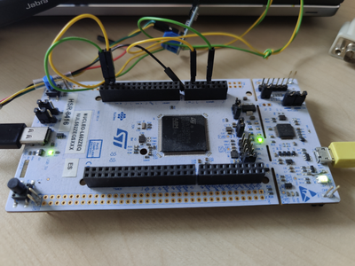

Laptop: Intel vPRO i7 ( Windows version 11)
Driver package: stsw-link009 (latest)
Hardware:
Verified successful installation of the ST-Link driver package (stsw-link009).
Checked all categories in Device Manager, including "Other devices", "Unknown devices", and "USB Mass Storage Device".
Used "Show Hidden Devices" in Device Manager (still unable to find any ST-Link or unfamiliar device).
Tested with several USB cables (known data-capable), switched USB ports, and avoided docking stations/hubs.
Tried manual driver update through Device Manager, but nothing related to ST-Link appears
Board power LED is on and the board appears to be powered correctly.
Tried on a different computer with Windows version-10 the behavior is still same

Hi @rajeshsrinivas You have a normal Intel PC, it should not have any issues. Please replace the USB cable, try another board.
Ask your IT if any enterprise malware for USB control is installed.
