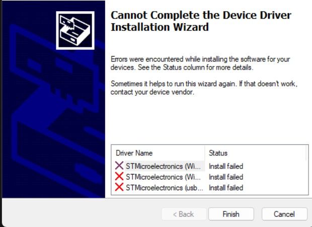

I have been trying various methods of installing the ST-Link USB drivers on my Windows 11 Laptop, with absolutely no success. Here is the output I see when I try to run the installation batch file from the stsw-link009 download:

When I open the properties on the ST-Link device, it (obviously) says that the drivers are not installed. Needless to say, if I try to run a program form the Cube IDE, I get a "No-ST-Link Detected" message. Also, if I open a project on the mbed IDE while the nucleo is plugged in, the board does get recognized. The board is the F091RC, although I am not sure that's relevant to my issues. The pre-loaded blinky program does work as well.
I am a beginner in this space, so please let me know if I'm doing something dumb. I've read and watched a lot of things to try and figure out, and everything I've found either completely skips over any issues with this (so presumably it isn't a normal issue) or they dive into writing custom INF, disabling Secure Boot, or other relatively extreme measures.

Advise already given in this forum quite long ago (besides of modification and signing the INF) was to manually install the in-box winusb driver for ST-Link in the Device manager. This maybe works for early adopters of Win11 but there's time for ST to recognize Win11 .
2022-02-28 1:27 PM
Thanks for the input. I had seen that some forum posters had gotten it to work on 11, but I couldn't achieve the same success. I guess I'll just hold out until driver support is updated for Win11! Fingers crossed for it to be soon!
