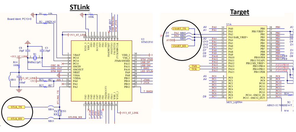

I know its an old thread, but can someone please confirm if my understanding is correct.
I can see that there is a connection between STLink Microcontroller (F103CB) UART and Target UART. Like its seen in below image. Is this UART used for the virtual COM port that is created by STLink to send data from target to computer while debugging? I always thought that the data is coming through the debugging channel (SWD). Never really paid attention until i saw this connection.
2024-12-28 7:43 AM
Your understanding is right. VCOM is coming from target U(S)ART.
