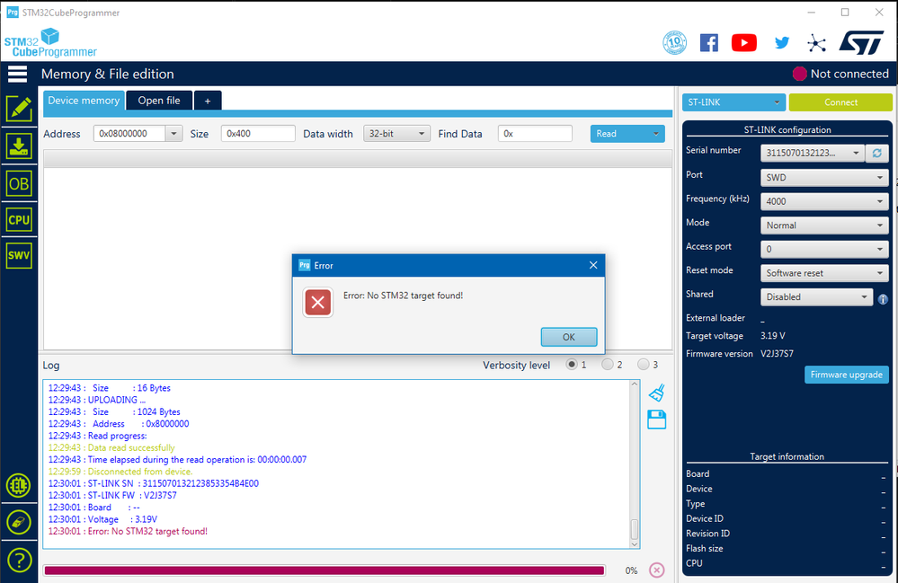

First of all I was trying to connect the board and I've got "No STM32 target found!" Error.
Second, after NRST Reset button was pressed (this option I considered on my board) and STM32CubeProgrammer Connect pressing, releasing NRST Reset button I succeeded to connect the MCU.

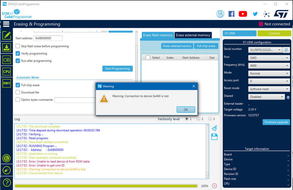

After that, I've erased the chip completely and tried to flash my bin file. But I've got errors reg., Connection to device is lost.
There are two errors in the log list: "Unable to read device id from ROM table" and "Unable to get core ID".

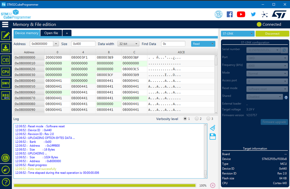

Ok then from your first image i see coe is flashed ok and connection is dropped after run app. This is normal if your code use power down modes as STOP or STANDBY, here too NRST line is required.

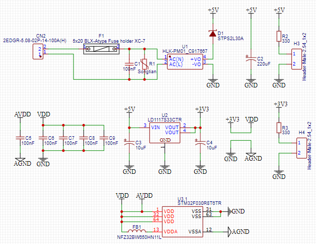

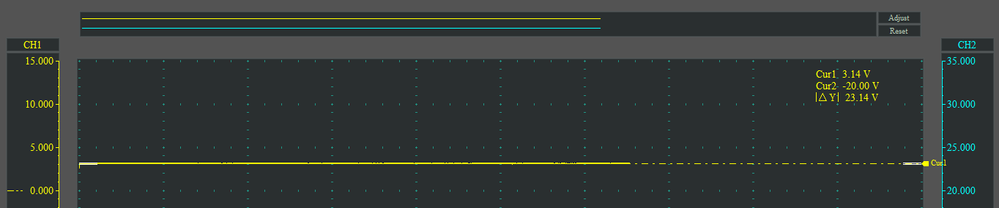

Send your PCB design or picture. Problem can be in power supply too. Try to measure noise in power suply lines by osciloscope.

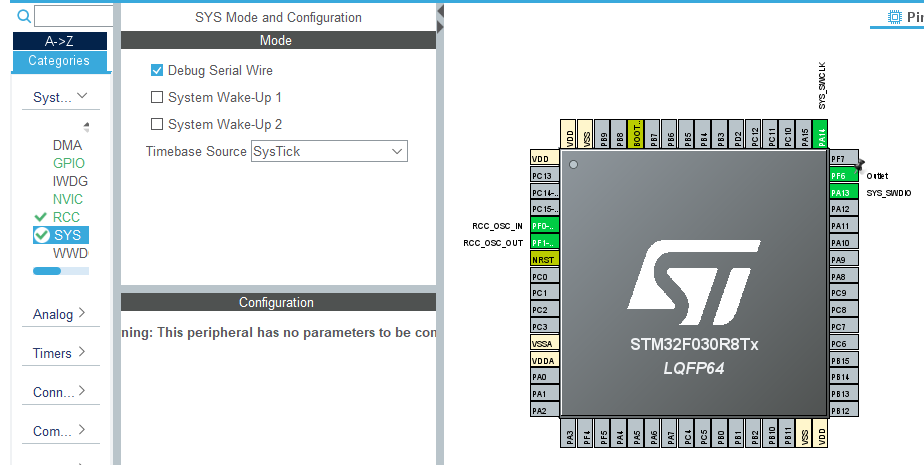

Seems your code use pins for SWD interface. No problem, but for reprogram this situatio code, STLink need control NRST pn with wire 4. Normal SWD need GND DATA and CLOCK only.
Dongle from china dont have connected NRST need customize ...
2022-10-15 4:00 AM
Below is the Schematic of the Power module for my PCB.
Also, I measured the Power lines with an Oscilloscope, which showed 3.14VDC.
The board has a supply from the dongle during flashing.
2022-10-15 4:03 AM
MM..1 (Community Member) thank you for your reply.
I don't use the pins for SWD Interface.
Below, is the MCU Pinout view for the Test flashing.
2022-10-15 9:06 AM
