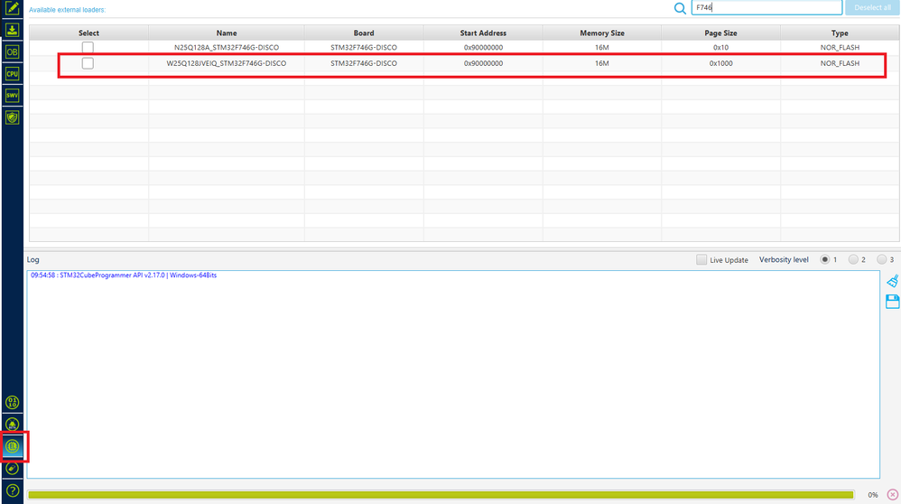

Why are you needing to copy the External loader? It's already available:

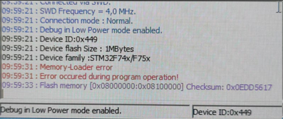

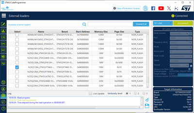

ok, I am using the STM32CubeProgrammer with External Loader but still not see the images stored on QSPI.
Soon I will update the log of flash phase
Did you succeed to Flash the external NOR flash with CubeProgrammer or not?
Be careful, there are two Flash loader as I shared previously, please select the correct one:
STM32F746G-DISO ver. B-04  with N25Q128A13EF840E
