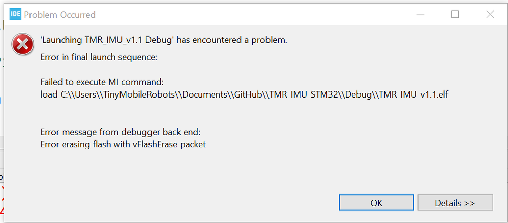

I have chosen the CPU that I have on my custom board (STM32F410R8T6), configured my periphials and written some code. However, I face an issue when trying to debug the program, or run it on the hardware. When I click the debug button, the debug viewer appears shortly, where i can press run and terminate, before it snaps out of it, and shows this error:

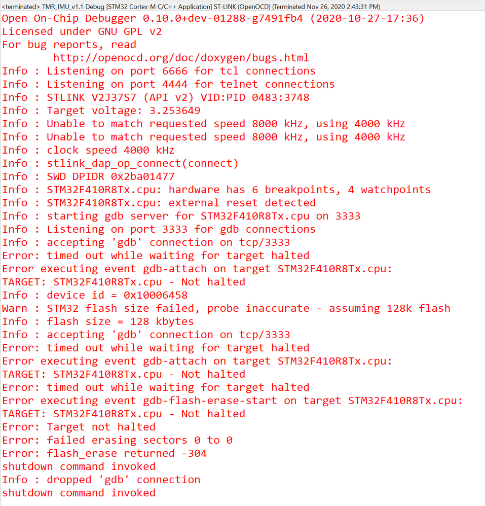

Using OpenOCD debugger gives the following output:
And console reads:

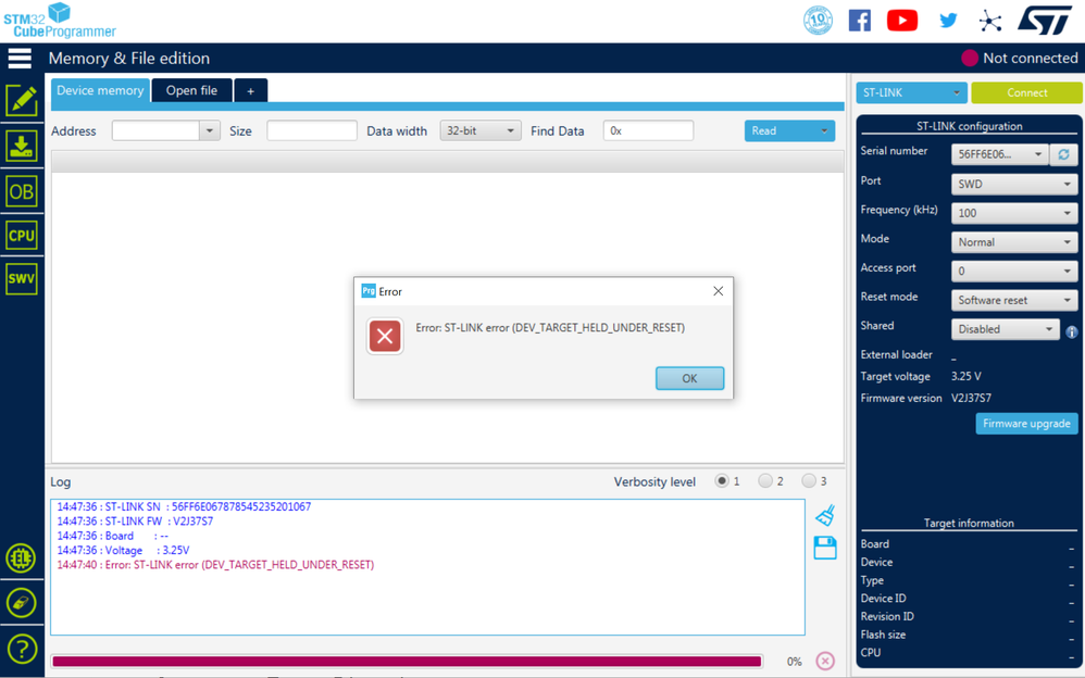

STm32CubeProgrammer seems to have issues with my ST-link aswell. I don't have any firmware opened, but when i press connect i get the following error:
2020-11-26 5:50 AM
It seems your reset pin is stuck to 0. Did you connect it to something else ? If not, check the wiring and if there is no solder issue on RST pin.
You can also try to use "software system reset", the reset will be done by software instead of nrst pin.

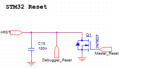

I have something else connected yes. Here is the schematic:
nRST is the reset pin on the STM32. Debugger Reset is the one from the ST-link and Master_Reset is connected to a pinheader, that is currently not connected. The idea is that the STM32 can be reset by the ST-link when debugging, and by another MCU when it is running in the field. I don't think this should cause problems, as the Master_reset is not connected in my current setup. The soldering looks fine.

Q1 gate is floating, hmm...
2020-11-26 6:08 AM
Maybe the Q1 transistor needs to have the Master_Reset pin not floating but at GND (via a pull-down resistor maybe).
2020-11-26 6:12 AM
Yess! I just came to that realization aswell! I grounded it, and now I connect. Thanks alot you guys!
2020-11-26 6:12 AM
Grounded it and now i'm all good. Thanks alot!
