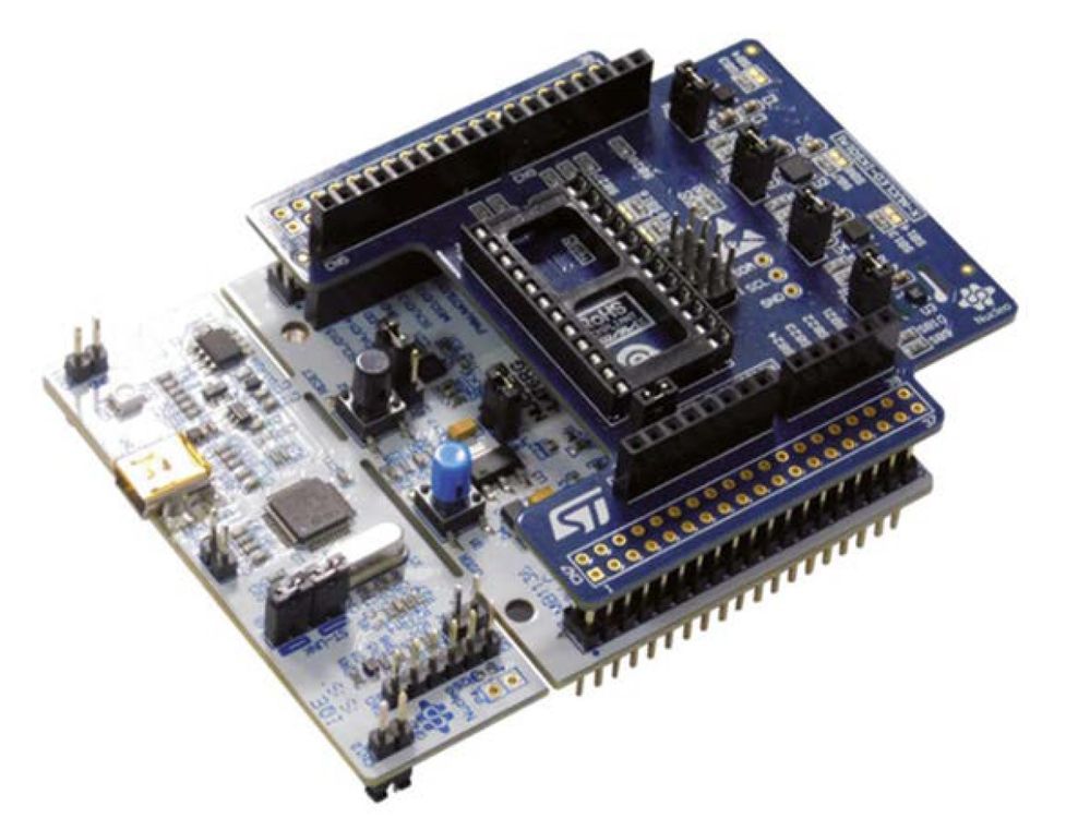

Still not clear. Can you, please, clarify what you mean under stacking (independently of complexity of custom board):
Here is an example of stacking on the Nucleo motherboard: the expansion board goes into morpho con, but the next board is supposed to be connected to Arduino con.

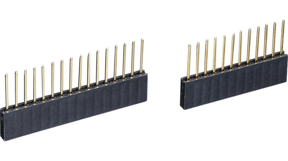

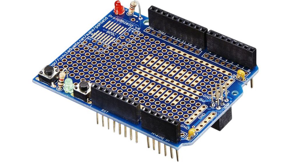

The only header that I can find for stacking purposes looks like this (Adafruit):
In assembly it looks like this:
Does anyone know of similar products from other manufacturers?
