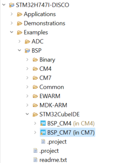

I opened the BSP directory of STM32Cube_FW_H7_V1.11.1 as shown in the project explorer below:
I compiled both the CM4 and CM7 projects and programmed them via ST Link (CM4 first), but the result is that the LCD screen of the STM32H747I-DISCO is filled with random noise and I cannot interact with the demo. Do I need to update some LCD drivers to make it work, or is there something else missing?
