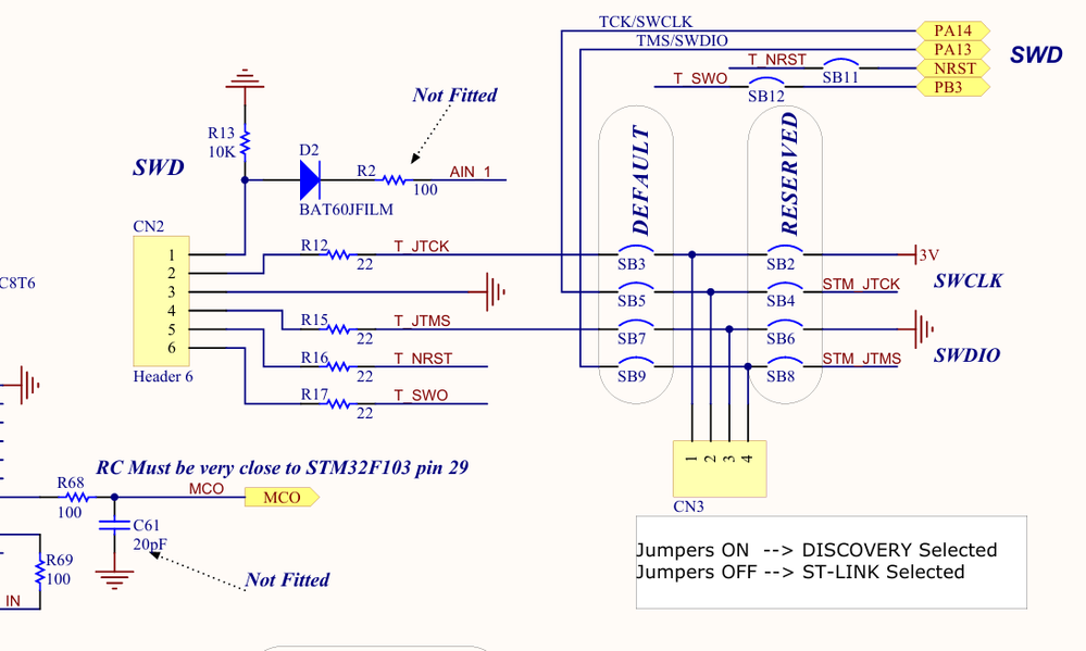

@richi wrote:I removed the jumpers to use only ST-link.
Show your schematic of how you connected between the Discovery board and the Riverdi board.
Did you remember to connect GND and Reset?

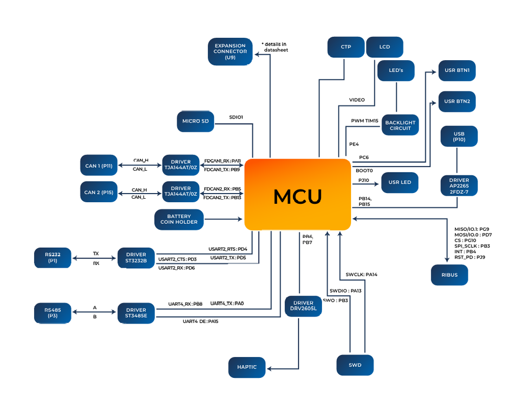

Riverdi board only offers block diagram:
On the stm32f4 side I just removed jumpers and connected pins 2,3,4,5,6 , VCC is given from an external power supply on through a power connector.
I was reading on internet that MCU could be bricked if I accidentally re-configured SWD pins for some other alternate function, what is the procedure if that is the case?

None of that shows us the actual connections that you have made between your disco & riverdi boards.
@richi wrote:I was reading on internet that MCU could be bricked if I accidentally re-configured SWD pins for some other alternate function
Not really "bricked" - but inaccessible to SWD.
@richi wrote:what is the procedure if that is the case?
