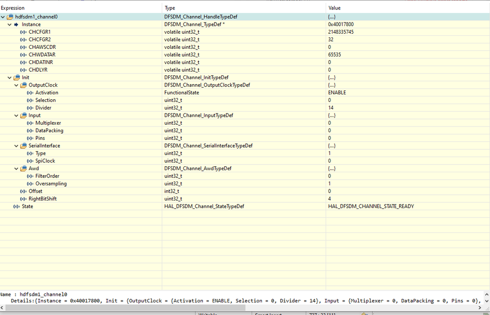

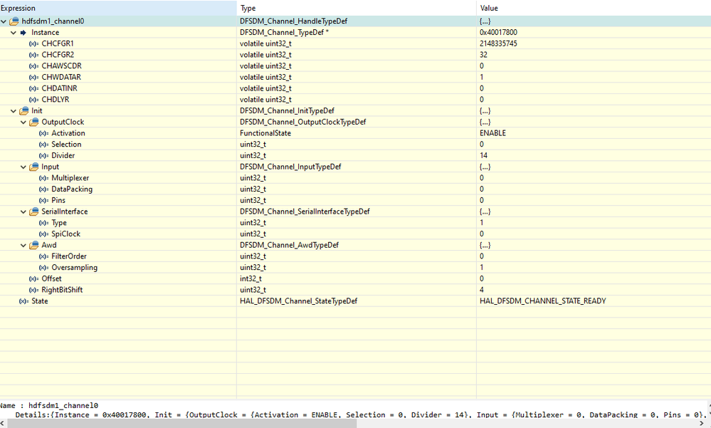

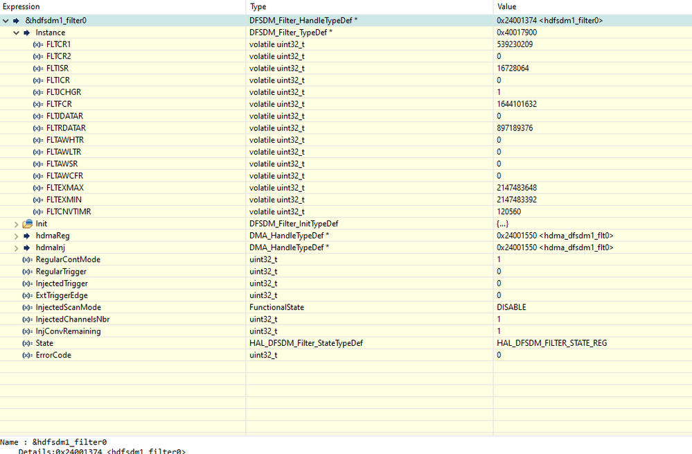

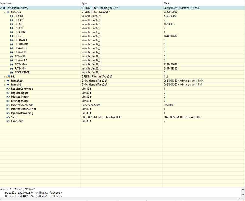

and doesn't fire ConversionHalf/Full Interrupts. I made Screenshots of the registers:
Channel 0 Without Resetting
Channel 0 After Resetting
Filter 1 Without Resetting
Filter 1 After Resetting
Caption describes what was before and after Reset. I see a difference in some Registers but i dont want to spend days again learning the registers and how they work. Does anyone have a solution or is there another way to change Oversampling Ratio and Right Bit Shift without restarting the controller?
