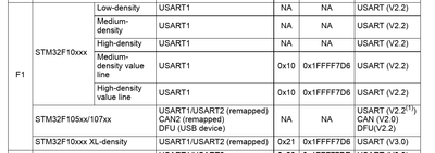

So you want boot from direct USB connection on Blue Pill , with F103 cpu ?
I see small problem here: F103C8 or CB has no USB boot built in.
see AN2606:
-> can boot from usart1 connection - thats it.
