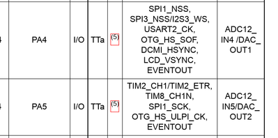

> I'm only using the PA4 pin
-- but PA4 is used on board :
and has pullup:
So maybe it depends on the behavior of the TFT , what PA4 doing as dac output.
-- You could try : PA5 , dac-out2 -- seems to be unused on disco
and has pullup:

2024-08-04 2:15 AM
Good.
And PA4 can do the same thing like PA5 - but not on this board, because on PA4 the LCD is connected;
so PA4 is not "free" /unused here .
see circuit of your board:
