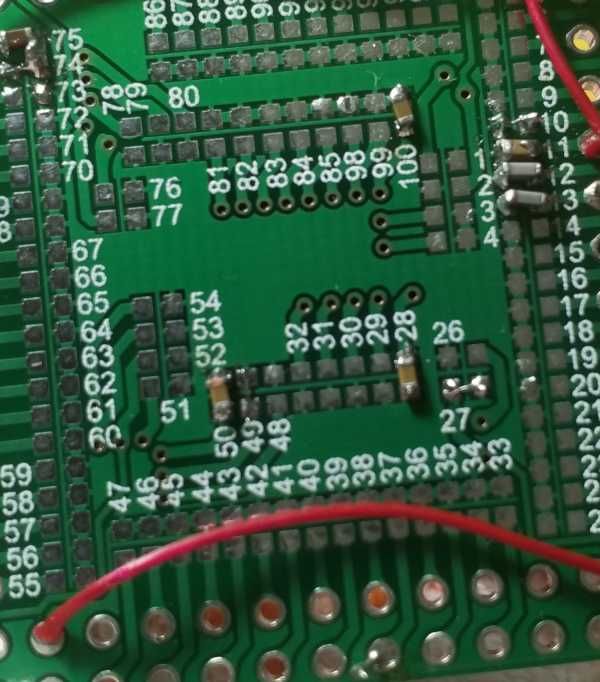

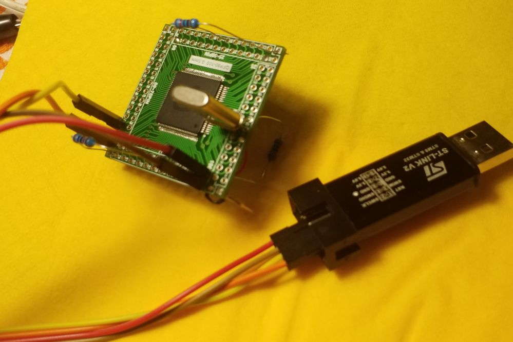

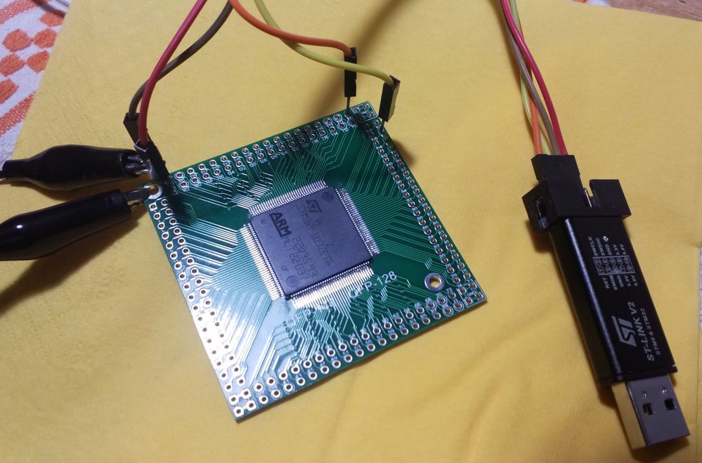

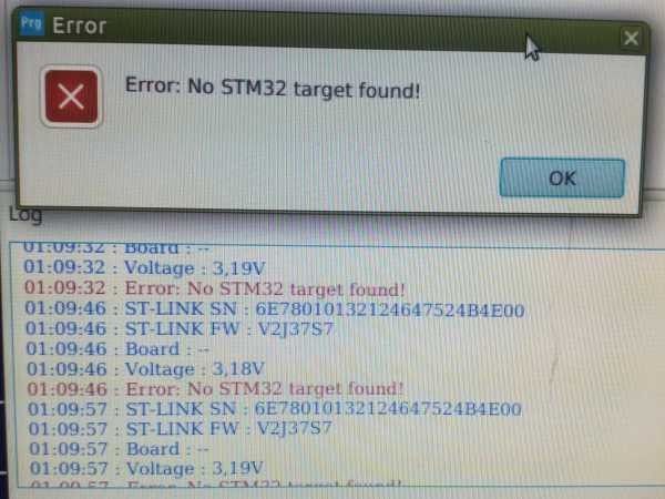

I recently bought the above mentioned two controllers and a boards (LQFP144/100 SMT to DIP Adapter PCB Board) where I soldered them with the necessary capacitors between all the VDD and VSS contacts. I properly connected SWDIO and SWCLK to PA13, PA14 pins, NRST to VDD over 10k resistors even boot0 over 10k resistors to VSS (This is how I noticed on all the schemаtics). There is no way I can read the microcontroller or flash it, although in addition to st-info and st-util, I also used STMCubeProgrammer and a linker on the Linux and Windows systems.

st-info --probe
Found 1 stlink programmers
 serial:   6e78010132124647524b4e00
 hla-serial: "\x6e\x78\x01\x01\x32\x12\x46\x47\x52\x4b\x4e\x00"
 flash:   0 (pagesize: 0)
 sram:    0
 chipid:   0x0748

The problem is solved!
The downside was that I didn’t connect VDDA to VDD because I felt it wasn’t necessary if I didn’t use ADC.
after I connected VDDA to VDD it worked.

You should have decoupling capacitors near the chip. You said you soldered them in your post but I don't see them on the boards anywhere. They're supposed to be close to the chip.

They are on the other side... 100nF ...

So no bulk capacitance? Design guide recommends 4.7uF min. VDDA connected to VDD?
