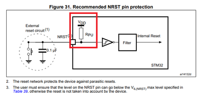

Hello @JACK8 and welcome to the community,
Could you please share your schematics? Knowing that no need to pull Reset pin up as there is an internal pull-up resistor on the chip connected to this pin:

The diagram @mƎALLEm posted can be found in the datasheet:
https://www.st.com/resource/en/datasheet/stm32f103c8.pdf#page=67
See also Application note AN2586: Getting started with STM32F10xxx hardware development:
