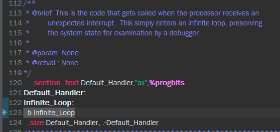

2022-10-19 12:25 AM
new project with C6 version (is really small program):
--- but still same effect: stalled in startup...
here pic - looks original - right ?

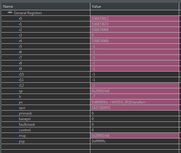

2022-10-19 3:31 AM
Could you send registers values table in infinite loop?
2022-10-19 3:36 AM
see in my post from yesterday, registers at loop. (in black area)
2022-10-19 4:06 AM
But they are from another bin file. We need from new bin file (for C6 MCU).
2022-10-19 4:38 AM
aaa. ok. BUT : now cpu is running !!
debug waits at program start in "main" , as usual.
just i dont know why...i set optimizer on -O2 (was -O0 );
i tried some times...now again stall in startup.
registers :
confusing...

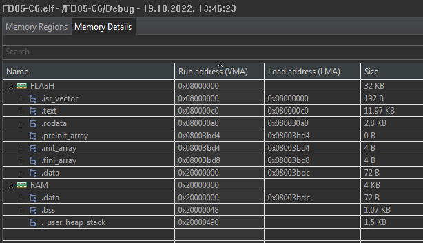

2022-10-19 5:21 AM
It si weird. Stack pointer (sp) has value 8160byte. Like there is 8kb memory set.
2022-10-19 6:21 AM
Check linker script (.LD)
Top-of-Stack needs to be 0x20001000 (4KB) or below. Check first vector.
Right now you're faulting directly out of reset, and perhaps into a catch-all handler everything points too.

and in IDE shows:
looking ok for me.... or not ?
